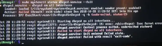

Please post text and not images. Just the important error message is stripped-down: dhcpcd(377): ... Exec format error ???
. With lack of further information I guess dhcpcd has problems to read its configuration file /etc/dhcpcd.conf
or maybe there is anywhere a cached malformed hostname. Please check if there are some unknown entries in dhcpcd.conf. You can look at the journal if there are some related errors shown with:
rpi ~$ journalctl --boot --unit=dhcpcd.service
You can also try to run dhcpcd
from the command line with the debug flag -d
set:
rpi ~$ sudo /usr/lib/dhcpcd5/dhcpcd -w -d
# or maybe
rpi ~$ sudo /sbin/dhcpcd -w -d
This should give you detailed output on the screen (stderr) what's going on.

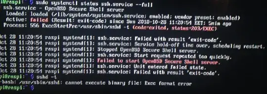

As I have learned from the comment it is very likely that /sbin/dhcpcd
and /usr/sbin/sshd
are broken or have been replaced. I also see just now that the error message:
Exec format error
is given on dhcpcd AND on sshd. Following the answer from @Valentin R. is a good advice for both packages. You can also first try to reinstall them with:

? ... also, your error messages include a "exec format error" ... this may indicate that, somehow, your RPi has a few x86 executables rather than ARM ... Are there any other changes, updates, modifications to the/etc/apt/sources.list
file, any PPAs added, any extra packages downloaded and installed ignoring as many errors as possible? – RubberStamp Oct 28 '18 at 12:12sshd
program matches the system configuration with these two commands: Check the libc architecture usingdpkg -l libc6
.... and then ensuresshd
is the correct one for that architecture using:ldd /usr/sbin/sshd
– RubberStamp Oct 28 '18 at 13:53file /usr/sbin/sshd
. – goldilocks Oct 28 '18 at 13:55dpkg -l libc6
->Name: libc6:armhf Architecture armhf
ldd /usr/sbin/sshd
->not a dynamic executable
@goldilocksfile /usr/sbin/sshd
:data
and/etc/apt/sources.list
has astretch-backports main
– The24thDS Oct 28 '18 at 15:26ls -l /usr/sbin/sshd
.... 2 What is the output ofstrings /usr/sbin/sshd |head -n 15
... It seems pretty clear that somehow at least some of the critical system executables have either been damaged or replaced... I would recommend getting a new SD card and reinstalling Raspbian. You should be able to retrieve any information that you may need from the current SD card once you have a working RPi... use a USB card reader to retrieve any user files. – RubberStamp Oct 28 '18 at 17:55
