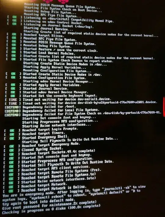

If I attach the resulting SSD to the RasPi it boots just fine and everything works. But if I try to grow the /dev/sdc2 partition (rootfs) using GParted, it won't boot successfully anymore. Here is a screenshot showing the problem(s):
Boot Error Messages
How can I resize rootfs without causing this problem?

    If you want help post actual file content - AND actual error messages. Your first step sudo dd if=/dev/sda of=/dev/sdb will produce an invalid disk. This could be done far more simply on the Pi itself using the SD Copy utility. – Milliways Sep 24 '18 at 00:20

  • @Milliways: I'll get the file contents and more important, the error messages. I'm aware this produces an invalid sdcard, specifically the second partition overlaps the disk size. However, the second partition is unused anyway. Every attempt to fix the disc partitions (using gdisk) resulted in missing bootmanager after saving the corrected partition table (sudo gdisk /dev/sdb -> delete partition 2, verify & write partition table) – DavWEB Sep 24 '18 at 14:52

As already discussed in the comments there is an issue with the boot-, root-partitions and with the master boot record (MBR). You can do it all by hand from a tar archive. So you have clean hand made partitions and even a hand made MBR. I have just tested it. I only use one USB slot /dev/sdb? on my laptop and I used a USB stick for the root partition. Here are the commands I have used to get it to work. For reference I used Raspbian Stretch Lite 2018-06-27, full upgraded with sudo apt update && sudo apt full-upgrade && reboot.
