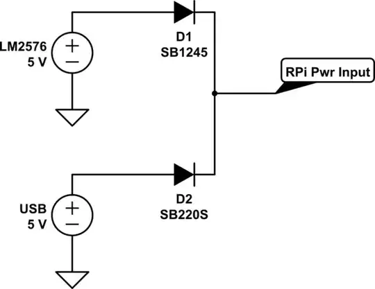

Approach 2: Use Different Diodes
Same principle here, but instead of tweaking the output of the LM2576-ADJ, we're going to use the standard LM2576, and give it "voltage priority" by using a diode with a lower forward voltage drop. The net effect is the same: The LM2576 will carry the load because its diode has a lower voltage drop than the one used for the USB supply:
schematic
simulate this circuit
The game in this circuit is diode selection. Both should be Schottky diodes; the one for the USB supply should have a slightly higher forward voltage drop. Ideally, the load and temperature curves for Vf will be similar. Again, the diodes here are not optimal, as that exercise is left for the reader.
