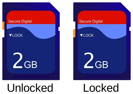

Physical write protection
Here's the image for those who had never used SD cards before.
Attribution.

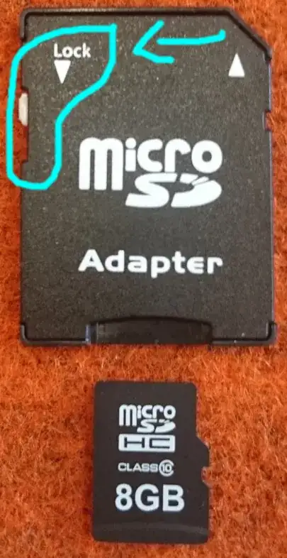

It is analogous for a micro SD adapter with a MicroSD inside: the dongle is on the adapter:
I had an issue with a card reader as well. The switch on the card I found does nothing, it is essentially a price of plastic you're sliding. That in turn activates another switch inside the card reader. In my case the switch in the card reader was bent a little too far so that it never made contact, and forcing it to mount read only no matter what. I bent it back very carefully with the tiniest pair of needlenose pliers ever and it worked fine. That's what worked for me. Hope it helps.
