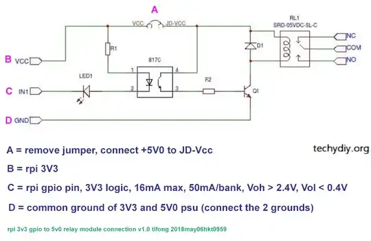

It is very likely that your module circuit is similar to that below.
relay module
Module spec says 5V High to trigger.
That means S input expects 5V to trigger. If your Rpi GPIO outputs only 3V3 actually a bit less), then the current through Q1 is not big enough to turn on the relay. The Led still turns on BUT NOT FULLY ON!
To prove that my guess is correct, you can do the following.
  1. Disconnect Rpi GPIO from input S.
  2. Use a jumper wire to connect input S to 5V, relay should turn on, with an audible click.
Then connect input S to 3V3, then blue led should grow brighter, the relay might turn on (because 3V3 is a bit higher than you GPIO signal). If relay is still not on with 3V3, then you need an external device to shift your GPIO signal higher, to above 4V perhaps.
There are many ways to level shift up your GPIO's 3V3 level signal to 5V0 level. You can google SE for more info.
I show below one similar relay module. I did the test without connecting to the rpi (especially not connected to the 5V pin on the RPi 40 pin socket. My module uses a different coil and NPN transistor instead of PNP. But I think the electrical characteristics should be very similar.

Actually logic level shifting might not be the easist solution for you. You may consider throw away your BJT transistor input module and get photocoupler based module. Then you can keep you gpio pin signal at 3V3 logic level, and the 5V0 power at JD Vcc is strong enough to energize the coil.
There are many advantages of using photocoupler. You might like to google to know more.
rpi 3v3 gpio to 5v0 relay module connection
