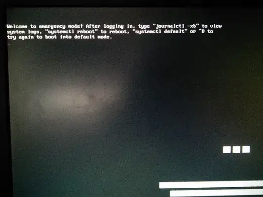

I have a raspberry pi 2 which I've had booting off a USB SSD hard drive for some time. Now I have bought a raspberry pi 3 and was hoping that it would be as simple as swapping the hard drive and setting the appropriate cmdline.txt
on the SD card of the new raspberry pi. Unfortunately, the pi 3 seems to start the boot process, but ultimately stops and reports a message starting with "Welcome to emergency mode!". The exact message is the same as the one shown in the image at the bottom of this post (but this is just an image from the internet, net what's actually shown on my screen)

In case it is relevant, during boot, I get a message:
a start job is running for dev-disk-by\x2dpartuuid-d96b7723\x2d01.device/start timed out
This runs for 90 seconds then the boot process continues. Looking through the systemd journal I see an entry like:
Timed out waiting for device dev-disk-by\x2dpartuuid-d96b7723\x2d01.device
There are other errors after this, but I guess this is the root cause?

/dev/mmcblk0p1
for the boot partition to see if that gets things going. – crobar Mar 22 '18 at 14:38/dev/mmcblk0p1
and have now booted successfully. – crobar Mar 22 '18 at 14:46
