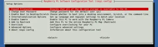

The official documentation recommend will be shown raspi-config on first booting into Raspbian. To open the configuration tool after this, simply run the following from the command line:
$ sudo raspi-config
Choice: Advanced Option(In the print is 8):
ADVANCED OPTIONS
EXPAND FILESYSTEM If you have installed Raspbian using NOOBS, the filesystem will have been expanded automatically. There may be a rare occasion where this is not the case, e.g. if you have copied a smaller SD card onto a larger one. In this case, you should use this option to expand your installation to fill the whole SD card, giving you more space to use for files. You will need to reboot the Raspberry Pi to make this available. Note that there is no confirmation: selecting the option begins the partition expansion immediately.
It has the following options available:
┤ Raspberry Pi Software Configuration Tool (raspi-config)
│        1 Change User Password Change password for the current user
│        2 Network Options      Configure network settings
│        3 Boot Options         Configure options for start-up
│        4 Localisation Options Set up language and regional settings
         to match your location
│        5 Interfacing Options  Configure connections to peripherals
│        6 Overclock            Configure overclocking for your Pi
│        7 Advanced Options     Configure advanced settings
│        8 Update               Update this tool to the latest version
│        9 About raspi-config   Information about this configuration
        tool
│                           <Select>
  <Finish>                            │
