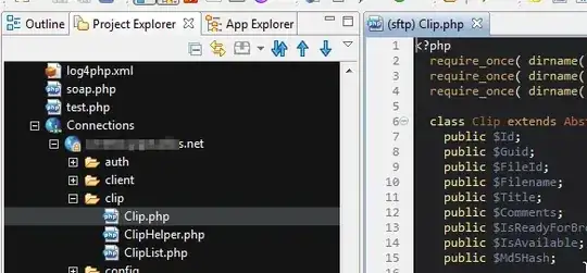

If you want to do web development, Aptana Studio can directly edit through FTP, or SSH (SFTP).
