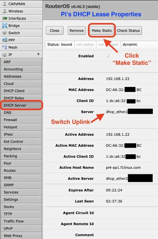

I've got a small switch I connect my Pi's to. This switch is uplinked to a MikroTik router that has a DHCP server listening on ether2 which the switch uplinks to. The router issues IPs for PI's connected to that switch:
[Pi]-------------[8-port switch]-------------[MikroTik Router]
This is what it would look like in the MikroTik's Webfig interface:
I go to the "LEASES" section of the DHCP Server and find my Pi:
Screenshot1
After clicking the Pi's lease, I'm presented with the option to "Make Static":
Screenshot2
Having made the "IP:MAC Address" mapping static, I can change the properties of the lease if I care to:
Screenshot3
Now let's review the IP Pool being served by the DHCP Server listening on ether2 that the switch is connected to is serving 192.168 or 10.0 IPs:
Screenshot4
