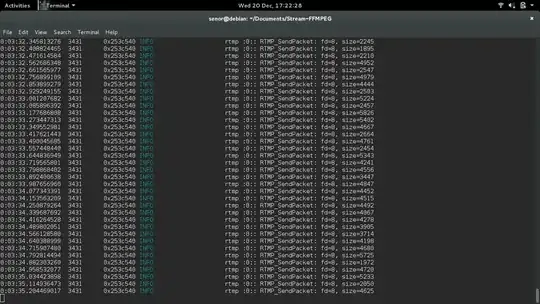

This is my laptop, running Debian with the same exact Python script: Laptop Log
The script was executed as "python3 rtmp.py". Both are log level 4.
