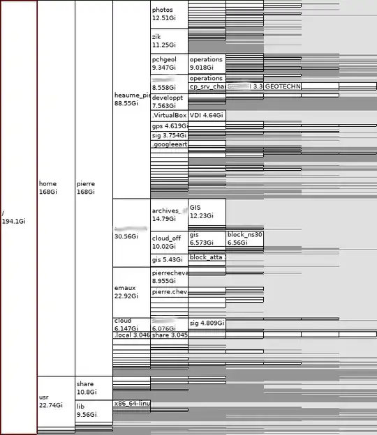

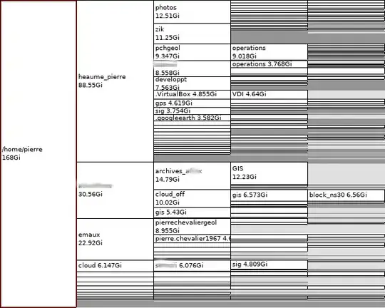

If you have an X display, xdiskusage is particularly handy.
To install it on a Debian or Debian-like system: apt install xdiskusage
To run it in order to find out which directory is taking up so much space within your home: xdiskusage ~ => here is the output from my own home: disk usage home
Larger directories are shown as large rectangles, the graphical output is ordered: biggest directories are shown first.
If you want to find out what is taking up space on your whole filesystem (preferably to be run as root, so that you have all necessary privileges to correctly get all directories' contents): xdiskusage /
Here is the output on my system: disk usage whole filesystem
You can browse through the directory tree by using arrow and Enter key. Enter bases the global view with its root at the selected directory, left goes up one level in the hierarchy (lynx-style): very handy.
Right-click opens a contextual menu with shortcuts. I only wish there would be a menu entry to "open a terminal here".
It is not as pretty as baobab, but it does the job.
Pierre
