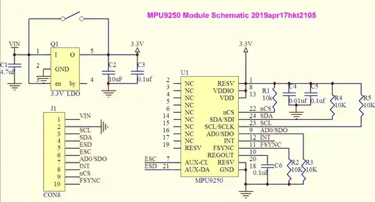

Anyway, I googled and found a schematic.
MPU-9250 9-DOF IMU Module - Thaou Electronics
mpu9250 schematic
