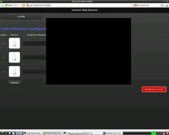

  1. Using Imagemagick which is pre-installed in Raspberry Pi. I pressed the printscreen key on the keyboard and attempt to paste it on that software. But failed.
  2. Open up a new terminal, i typed the following:
    sleep 5; import -window root myscreen.png // printscreen after 5 seconds
This is what i got.
imagemagick printscreen

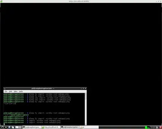

Type
This is the black screen that i got.

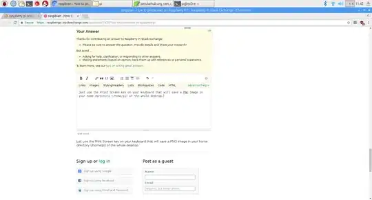

Just use the Print Screen key on your keyboard that will save a PNG image in your home directory (/home/pi) of the whole desktop. enter image description here

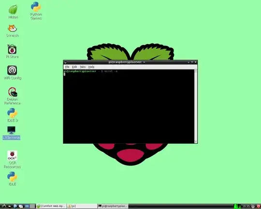

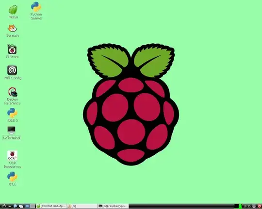

Yes i did it! thanks to M Noit :)
sudo apt-get install scrot
then, to take a screenshot after 5 seconds delay, (i got the screen with the terminal in it too! so i need some delays. Also, i can't execute that command through puTTy)screenshot without delay
$ sudo scrot -d5
and i get a nice screenshot! :D screenshot after 5 seconds delay
