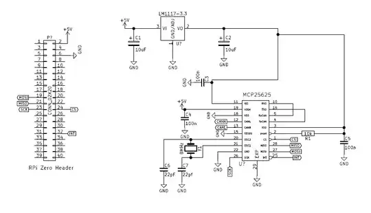

I have been developing an expansion board for my RPi Zero, which contains a power supply based on the buck converter TPS62130 (5V/3A) by Texas Instruments, a USB Hub and a CAN Controller/Transceiver MCP25625.
The controller/transceiver is being fed with two voltage leves, 5V from the buck converter to the transceiver and 3.3V from a voltage regulator LM1117-3.3v to the controller. I used a voltage regulator because the 3.3V output from the RPi Zero would not be able to supply the necessary current.
The MCP25625 is basically the MCP2515 controller and the MCP2551 transceiver in the same chip.

The board is a PCB and everything is soldered just fine, but perhaps I've made some silly mistake in my circuit. Or maybe I'm forgetting some middle step.
I am attaching part of my schematics in the hopes someone will find my mistake.
Board schematics
Is it really possible to simply change the MCP2515 for the MCP25625?
Have I made some silly mistake in the circuit?

you dont need the 3v3 regulator, you can run the IC all from your 5v buck, connect VDD,VDDA and VIO all to 5V
