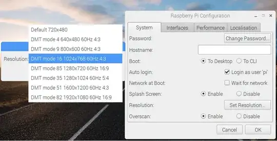

I did this all in headless mode via a VNC session on a fresh Raspian Stretch install, using VNCViewer 6.0.1 on Windows.
Perhaps you aren't given any resolution options because you have already forced a resolution - have you tried editing config.txt to set the video mode back to default?
For reference, here's my /boot/config.txt file:

This corresponds to a display resolution of 1024x768 @ 60Hz according to the config.txt documentation
Here's the options that are presented in the resolution settings: enter image description here
I find the drop-down a bit touchy, you need to click and hold to get the list to display correctly.
