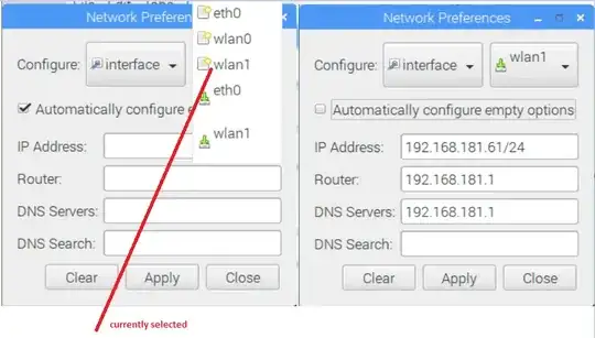

EDIT
Here is something I noticed a few minutes ago. In the network GUI the interface "wlan1" appears multiple times. One with dynamic and one with static IP. However, I can't see multiple interfaces when calling ifconfig -a
or netstat -i
or ip link show
. They are only appearing in the GUI:
