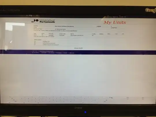

I used apt-get install for the matchbox-keyboard to be used as an on-screen virtual keyboard solution.
Just look at how small the keys are! Barely touchable and super inaccurate...
The real question is if anyone knows of a way to make the keyboard bigger, could recommend other solutions or tweak the config? I am a total debian newbie so I really hope I get some help here. :)
