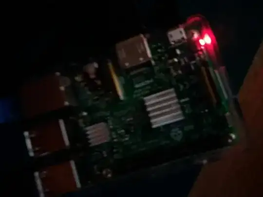

I was using my pi 3 with the official power supply and compatibleenter image description here keyboard and mouse. I was just using geany like I normally would when the lightning bolt appeared (the sign for overloading the pi) and then the screen turned blank. Now it won't boot and the red light shows. I have another pi which I have put the sd card Into and the card still works. Any ideas on how to resolve?

  • @Dr_Bunsen I have tried different power supplies and sd cards and also other peripherals since this and the pi just will not boot. Also I didn't intend to come across as aggressive. – that_raspberry_pi_guy Apr 24 '17 at 14:28
  • Did you short the pi? Or damage it by under powering it? I read something about that being a source of damage. – Dr_Bunsen Apr 24 '17 at 15:24
  • @Dr_Bunsen i have a case on the pi so i cant access the gpio pins. This rules out shorting I think. I doubt that I underpowered it as i am using the recommended supply from the pi foundation. However there could have been a fault in that supply leading to underpowering or shorting. – that_raspberry_pi_guy Apr 24 '17 at 15:29
  • Open up the case, post pictures. There really isn't much information for us to work on. Did you try the non logical answers like another SD(I know your SD card works on other PIs) or whatever. Just disconnect everything and connecting it again? Did you try another power supply? There are lots of things you could try and maybe there is a flaw somewhere. Or maybe you had a bad Pi that is the root of your problems. – Dr_Bunsen Apr 24 '17 at 15:50
  • @Dr_Bunsen i have tried some different peripherals and they don't work. I've used other sd cards and also a different power supply. I will post some pictures shortly. – that_raspberry_pi_guy Apr 24 '17 at 15:54

    The red led is part of the 3.3V system and so could not be on if the polyfuse were blown https://www.raspberrypi.org/documentation/hardware/raspberrypi/schematics/RPI-3B-V1_2-SCHEMATIC-REDUCED.pdf <- The fuse ("MF-MSMF250/X") is top left, the leds are in the second row on the right. – goldilocks Apr 24 '17 at 13:04
  • @goldilocks ok, so this points away from the cause being a short? – that_raspberry_pi_guy Apr 24 '17 at 15:30
  • Not necessarily. There could still have been a short that actually damaged the Pi, if it bypassed the polyfuse, etc. But if nothing helps you could cross your fingers, leave it for a few days, and see. – goldilocks Apr 24 '17 at 16:07
