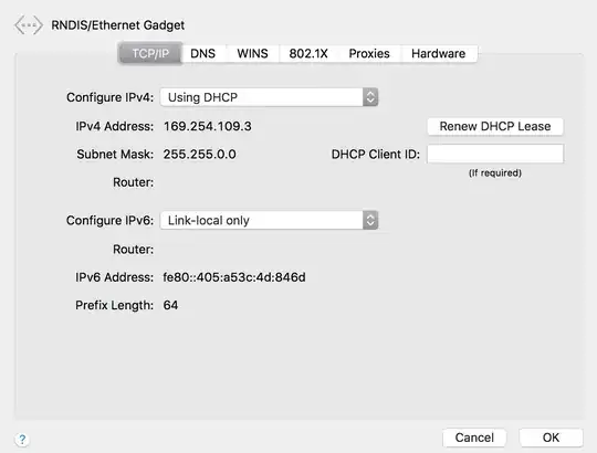

  5. Configure the RNDIS/Ethernet Gadget exactly as shown:
https://gyazo.com/f75f56e667b25a8708c3d4bbb03ff684

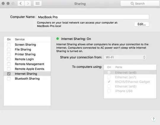

  1. Turn on Internet Connection Sharing (ICS):
https://gyazo.com/697e4cafca6e77c17e6e382aa284f328

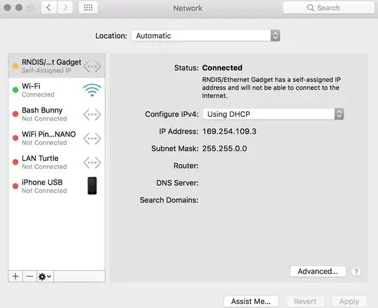

  2. Wait for the Pi to boot up. If you see the Pi0 obtain a Self-Assigned IP with an Amber light, don't fret, according to Re4son: "I don’t know why Apple decided to go with an amber light instead of green but amber seems to mean “All ok, this MacBook assigned an IP address to your pi, you are ready to rock’n’roll””:
https://gyazo.com/b9037ca3330c8ef60e6f406e3a4a33bd

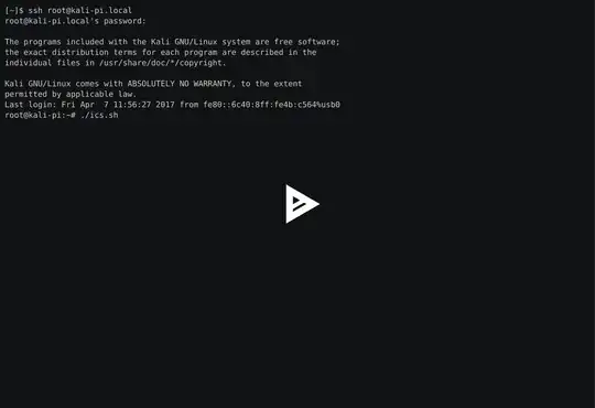

  1. ssh into kali-pi.local if using Re4son's Kali Kernel: ssh root@kali-pi.local
  2. Run ifconfig usb0 to see if the Pi0 has obtained a valid IPv4 address. If the Pi0 did not obtain a valid IPv4 address then run: ifdown usb0 && ifup usb0.
asciicast
