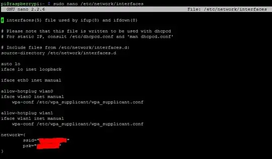

I have the pi connected to my router with a cat7 ethernet cable. The cable works as it should when I plug it into my desktop. I am running Raspbian from an 8 GB sd card. I have the pi configured with a static IP address so I can easily establish an SSH connection. I can connect to it with SSH end VNC, but I can't access websites. When i try to ping www.google.com it returns: ping google.com However, when I ping my router's IP it does work. When i ping other devices on my network it also doesn't work, but it doen not return an error. It just takes too long for my patience. I have played around with the /etc/network/interfaces file. These are the contents: Interfaces

  • "configured with a static IP address" HOW? WHY? (Most people get it wrong.) Don't paste images, they are very difficult to read, paste text. From what I can see you are using a non-standard networking setup. See How do I set up networking/WiFi/Static IP – Milliways Mar 26 '17 at 22:57
  • How did you setup your 'static' IP? at router or configure it at /etc/dhcpcd.conf? I suspect that your dns is not working, but can't help until you show us on how you configure your network. – hcheung Mar 27 '17 at 09:52
  • I set up a static IP with /etc.dhcpsd.conf to make it easier to SSH into the py. That way I don't have to look up the IP every time. I removed what I changed in that file, and the issue with the outside internet connection over ethernet dissapeared, although I still can't connect to wifi networks. – Julian Sanders Mar 27 '17 at 16:43
