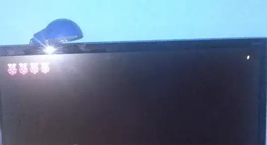

I am new to raspberry pi. Here is video what is happening when I plug it to main and my HDMI monitor Recording.
Screenshot from accompanying video
At the end of this video I tried to show what type of power supply I use, but it's below too:

It looks like you're having a power issue.
What power supply are you using - and what is it rated (Volts and Amps please)?
See the yellow lightning bolt? - that means there is a power issue.

I think I found the reason.
It was a faulty USB cable that I used to power my raspberry Pi, I tried a different USB cable with this adaptor and it works!
