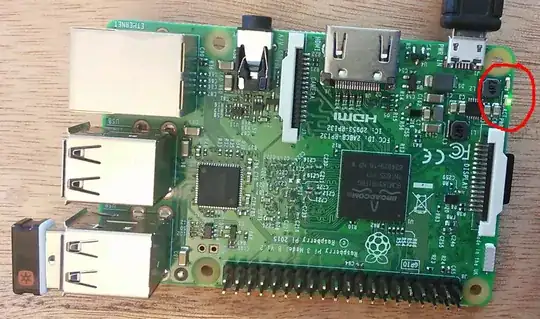

However, for the RPi 3 (which is brand new, the video shows maybe 3rd or 4th boot after unboxing), I observe that once the boot process starts, the red LED occasionally turns off while the green LED may or may not be on, and then mostly comes back:
This can be seen on: https://vid.me/vwHw

Ok, thanks to the answer from @Milliways, I decided to make another test with powering the RPi 3. First, I should note that the tests in the OP question were made with a USB hub, which comes with an adapter that is rated 5V, 2A DC. I was sort of expecting that if there is only one USB load in the hub, that all of the available 2A current would be given to this load - but it is also quite possible that each port of this hub is current-limited to 500 mA, regardless of how many USB loads are connected. Also, here I tried a different Rpi 3 board connected on this same hub - and it also exhibited the red LED blinking during boot.
Anyways, to get rid of this unknown, I soldered myself a USB 'power' cable, powered directly from a Thandar TS3021S adjustable PSU. This PSU is rated at max 2A (which is less than the RPi 3 maximum of 2.5A); I've set the current limiting to some 1.9+A -- and as a bonus, the PSU measures/shows the actual current used on its LCD.
So, here are the results - when I set the PSU to 5.01V, the red LED still blinks (it's a bit hard to see on the video, but is still visible):
  • video - https://vid.me/Gmsq
  • rpi3_boot_led_psu501
What is strange, is that the current measured rarely goes over 0.5A during boot, so it didn't seem to me that lack of current is the reason for the red LED blink (although, arguably, the "refresh" rate on the LCD of the PSU which shows the current measurements could be slow enough, so as to obscure some current spikes, if any were occurring).
At this point, I measured V26 (voltage on pins 2,6) - which should otherwise provide Vcc - it measured 4.72V, that is, roughly some 0.3V less than the input voltage.
So, at this point, I started increasing the voltage supplied by the PSU. First I increased to 5.45V; in this case, the V26 was 5.15V - and while the frequency of red LED blinking decreased, it still did turn off at times.
In the end, I set the PSU to 5.94V; in this case, the V26 was 5.63V - and finally, there was no more red LED blinking!
  • video - https://vid.me/S6Qt
  • rpi3_boot_led_psu594
The current use in this case seems roughly similar to the previous case, so I would assume, that it is not a problem that the PSU can deliver less than the RPi 3 max rating of 2.5A -- but the problem was that the voltage was too low; so with a power supply voltage of close to 6V, finally the red LED turn-off issue is not there anymore.
