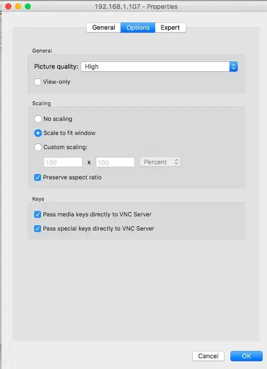

As you are Using the New VNC for Raspberry PI , Make sure you Have Latest VNC on your Client PC. then
  1. open your VNC Viewer
  2. Right Click on your Raspberry pi
  3. Click Properties
  4. Go to Options
  5. . Scaling to Fit to Windows or as you want
