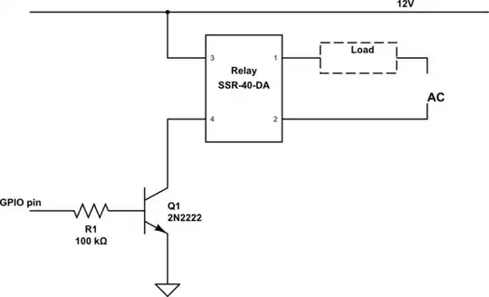

This question on electrical engineering SO seems to indicate that these are supposed to be driven directly from an MCU output (e.g. Arduino pin, Raspberry Pi GPIO pin etc).
However, if @stevieb suggests the GPIO output cannot trigger them, then you just need transistor and a higher voltage.
schematic

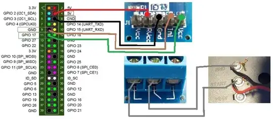

schematic for connecting relay to raspberry this image find in google
tutorials for learning "how to use GPIO pinout raspberry"

The SSR datasheet says that you need to source at least 7.5 mA to trigger the relay. So you need to use a transistor like that in KennetRunner response but the 5V line is enough but the resistor must calculated depending on transistor's HFE, that of 2N2222 is greater than 35 so you need a resistor not bigger than 22k (I suggest 10k to be safe).
Remember that the RPi has very weak GPIOs.
