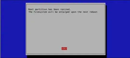

On the first boot, I get the blue screen (see picture below) for 1-2 seconds.
"Resized Root filesystem. Restart in 5 seconds." (<- this is the right text; picture is only an example!)
But the filesystem is not expanded!
