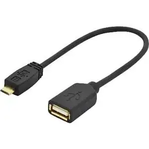

Another solution is to buy an OTG cable which will enable you to use the hub you have:
