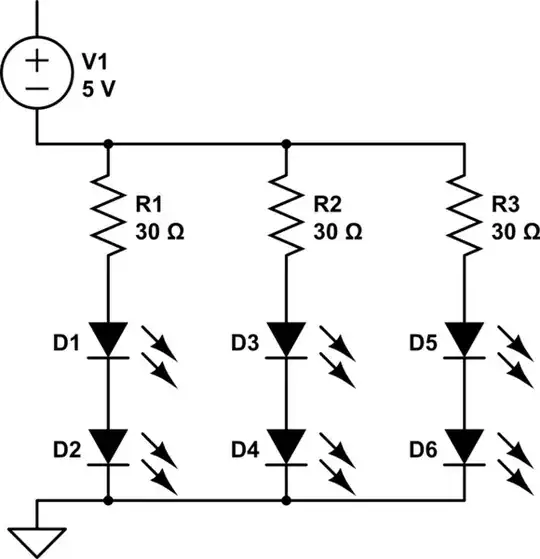

If that is still okay, then you must connect the LEDs in parallel, because the forward voltage drop of the LEDs is additive in series. So likely you could hook two of them in series to 5V:
(5 - 1.6 * 2) / 0.06 = 30 Ohms
Of course, this still only gives you two LEDs. However, you can get a lot more than that by connecting them in parallel. You can actually combine the methodologies:
schematic
So this is 6 LEDs in three parallel banks of two; each bank consists of a 30 Ohm resistor and two LEDs. Doing them this way instead of one LED per bank (which is the most you could get on a 3.3V pin) means that you are consuming less current, because each bank still only draws 60 mA. Presuming you have a 2A supply to the Pi, you should be safe running at least 10 of those from the 5V rail, which is probably more you need.
On new models of pi, the 3.3V rail should be good for this as well -- but I am not positive this actually includes the Zero, and in any case, because of the potential of using 2 LEDs in series, 5V is a better choice here.
This still leaves you with the issue of the LEDs being on all the time, although the total power consumption is probably < 1 W since each of those banks uses:
(5 - 3.2) V * 0.06 A = 0.1 watts
Note that you could control each bank individually, but in this case it sounds like that is not necessary, so you would instead control the whole thing using a single transistor. However, you might want to consider the use of a ULN2xxx type integrated circuit; these are at most only a few bucks a piece (although you probably have to buy 5 or 10) and allow you the option of controlling each bank.
They control via the ground, i.e., in the above circuit the second resistor of each bank would be connected to an a pin on the ULN's output side, and the 5V supply would be routed through it. The pins on the other side of the DIP are connected directly to GPIOs on the pi to turn each bank on or off.
I've run arrays of smaller LEDs using a ULN2803APG from the 3.3V rail this way before.
