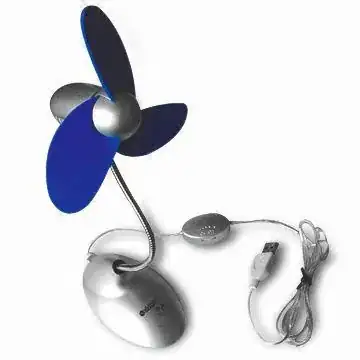

You can use one usb fan with "on/off" switch.

  • I don't really understand why is your comment so rude ? You never said you did think about the switch! I tried to help you (help: Is not that what you asked for). But, I understand you frustration, see my edit. It seems that the question has already been asked and answered. – David Mar 13 '13 at 11:25
    Dont worry about it David - Maybe it was not the answer for the OP - But somebody else might like it for another circumstance. Your answer is good. +1 - Not sure why you got downvoted- The OP said he does not have an on.off switch and you showed him where to buy one with an on/off :) -1 was not needed here and a bit rude. yes :P – Piotr Kula Mar 14 '13 at 12:30
    David, indeed you shouldn't worry, but your answer just doesn't answer the question, which is how to cut the power coming from the pi's usb ports. So it's not a good answer. I am surprised you did get any up votes at all. – Jaap Versteegh Aug 10 '15 at 08:14
    This did not answer the question. – Dr. McKay Jun 16 '18 at 19:28
