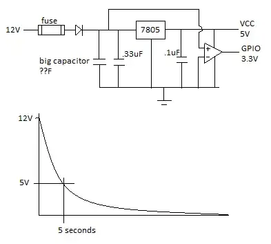

I want to use my Pi as an XBMC server in the car. The XBMC docs say that you should always use the shutdown command before disconnecting the power.
I've been thinking that it should be possible to create a simple circuit with a capacitor and probably a diode to detect when the power supply was disconnected (and raise an interrupt on one of the GPIO pins) but the capacitor would provide current long enough for the system to shut down properly.
first draft
Does this look correct and sufficient?
...Actually, I think it would probably be more like this:
second draft
What kind of capacitor would I need to store enough charge to keep the Pi going long enough for XBMC to shut down properly?

  • What is with the "GPIO 3.3V"? In the first circuit it will just pull down the 3.3V rail with the bottom resistor, and the second connecting the output of an Op-amp running from 5v single-ended supply to GPIO with the inputs as set will have the op-amp driving its output close to 5V as hard as it can - which is not going to help the 3.3V supply to the Pi (it may kill the Pi). The use of a Linear Power regulator (7805) is just going to waste the limited charge in the ?? capacitor. I would "-1" this but the question is good even if your suggestions are poor. – SlySven Dec 20 '15 at 19:31
  • I dont think any kind of capacitor will do as it may take up to 30 seconds to shut down a Pi. You may need to look at a tiny UPS system instead. Or you cant try this, but its a 90USD project. http://www.instructables.com/id/The-Forever-Rechargeable-VARIABLE-Super-Capacitor-/ – Piotr Kula Dec 20 '15 at 21:03

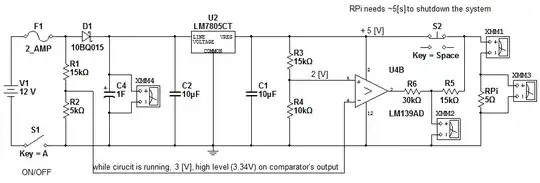

Comparator's output goes to GPIO pin (in this circuit there is placed multimeter instead) so that Raspberry could check if car's ignition is still on. Everything else is explained by the previous speaker. "S2" is a reset buttun - just in case. In the picture you can see XMH4, XMM1,.. Don't care about it. I've used it only to check interesting parameters while testing circuit in Multisim. My only question is reaction to rising temperature. Perhaps, there will be need to change the values of resistors in voltage dividers.
Edit: I've realised that in spite of the fact that the cirucit is surely correct in the theory, it is useless. Cost of such a big capacitor (1F, 12V) is unacceptabe high. Another solution might be connecting voltage regulatior stright to acculumator and using voltage comparator between car's ignition and the battery.
swojczak
    Hello and welcome! Thank you for your contribution. Care to explain the workings of your circuit? – Ghanima Dec 09 '14 at 16:36
