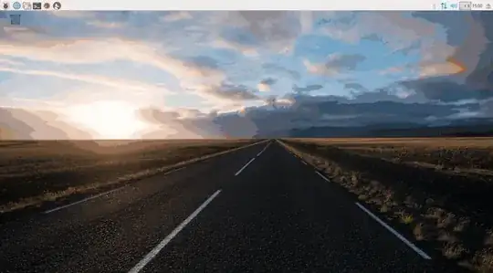

There is a quick graphical way to change the keyboard layouts, the toggle key-combination and have a panel indicator at the same time.
Add/Remove Panel Items
Add
Close
Keep system layouts
