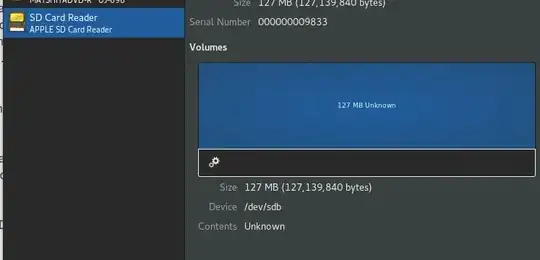

Now here is the funny thing. The card which is a 16 GB Intenso micro-SD with adapter to SD for the laptop, doesn't automatically mount or anything. In the Gnome 'Disks' utility, it shows as a '127 MB Unknown' volume:

What's wrong here? It appears the micro-SD is not registered at all (neither by the RaspPi nor by the laptop), although it worked flawlessly before.

  • Thanks for the extensive answer. fdisk -l did not show any partitions. e2fsck will not work for sdb1 or sdb2, but for sdb it says "Bad magic number in super-block" and other things, so I guess I'll declare the card "lost". – 0__ Jul 11 '16 at 12:18

As @Milliways points out in the comment, most likely the SD committed Harakiri. I bought a new card, it was recognised by the laptop, I installed Raspbian again and the Pi did boot up again.
I still wonder how this can happen - and if it's a warranty issue for the card (it was less than two weeks)...

  • @goldilocks Yes, but the detail in the question shows a Volume of 127MB. You can format that, but it will still remain 127MB. – Milliways Jul 12 '16 at 00:10
