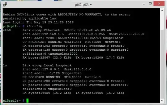

ifconfig before setting static ipifconfig

You have not provided sufficient information to give a definitive answer. You should post what ifconfig shows BEFORE attempting to set static (or get this form another computer).

  • i have added ifconfig info before setting static ip pls check – Owaiz Sahreef May 19 '16 at 23:18
