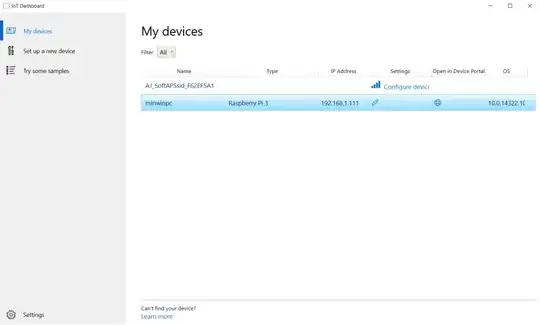

I had very similar problems - I found the length of time for the first boot increases with the size of the card (so I'd expect that a 32GB card could be 15 minutes or more).
You mention you've got it connected on ethernet - look at the list of devices on your Windows IoT Dashboard. If you can see it there then you know it's working at least. I sometimes find that the first boot finishes with an error - after 15 minutes I got a CRITICAL_PROCESS_DIED error, but it automatically rebooted after that, and after a shorter period of time it took me to the Windows IoT set up screen.

  • Thanks for the answer. I still can't get it to work though, I let is go on booting for 70 minutes without succes. Also it doesn't show up on the dashboard. I'll just wait for a newer build of IoT, I can't think of anythink I haven't tried that could fix it, apart from buying a new sd card/raspberry.. – RuteNL May 18 '16 at 22:59
  • That's a shame to hear that @RuteNL. If it helps, v14342 is available now on the Windows 10 IoT Core download page. It could be worth trying to flash the card with this, the try booting it with ethernet, and if that doesn't work, reboot and try with WiFi? – Alpha Reever May 19 '16 at 08:44
