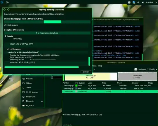

Now a separate window will show up with /dev/loop0 .. you will see two mounted partitions a boot and a root partition.
gparted snapshot
In my case the root partition had about 3.74 GB unused space, so right click on root and click resize and reduce the free space to about 10-20MB then click apply.
