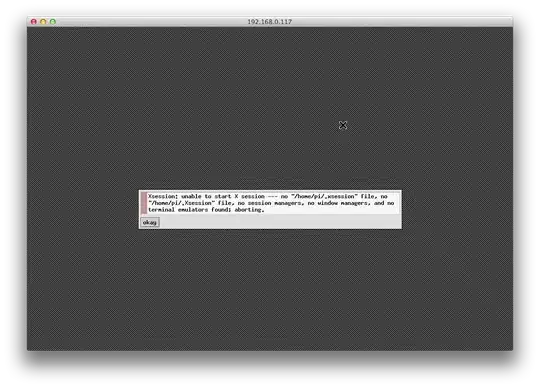

You can login to your Raspbmc using ssh. Once logged in install XRDP (Or any other of the RDP solutions Remmina, rDesktop) All ways to install these are in the other question you mentioned.
How to install XRDP Run the following command once your logged into your Raspberry Pi over SSH.
sudo apt-get install xrdp
How to make it run at boot. Following is from the link, more elaborate ways can be found with Google.
With LSB tags, you can:
- add:
update-rc.d xrdp defaults - remove:
update-rc.d xrdp remove
1This solution works on Raspbian and other flavours that come with the X11 window system. – Marius Butuc Jan 27 '13 at 00:59
