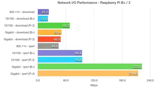

Combining the ethernet with that is unusual, but it's worth noting that USB 2.0 should provide 480 Mbps whereas the 10/100 ethernet connection would require at most 100 of those.
Wikipedia notes, citing spec as a source, that, "Due to bus access constraints, the effective throughput of the High Speed signaling rate is limited to 280 Mbit/s or 35 MB/s"; whether that means per port or for the bus as a whole is unclear.
to what effect is data transfer slowed down
Obviously you won't get more than 480 Mbps total, and you probably won't get more than 280. Personally, I've never seen or heard reports of a pi doing better than 10 MB/s transfer from local ethernet to a USB drive (i.e., 80 Mbps) consistently for normal purposes. However, that number is after the protocols themselves have been handled, which will add a variable but I think small percentage -- with ethernet it may vary greatly depending on the topology and activity of the connected network.
