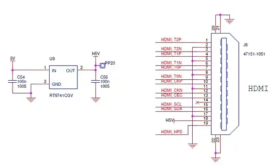

Finally, the schematic for the Pi 3B shows that it uses yet another component, an RT9741CGV 100mΩ, 0.7A High-Side Power Switch:
RPi Model 3B V1.2 / HDMI power circuitry
It looks to me as if the original model boards and the Pi B+ will allow up to 200mA through the HDMI socket. The Pi 3 should allow up to 700mA through the HDMI socket. As far as I'm aware there are no schematics available for the Pi 2 or the Pi Zero, which leaves them in uncertain territory.
