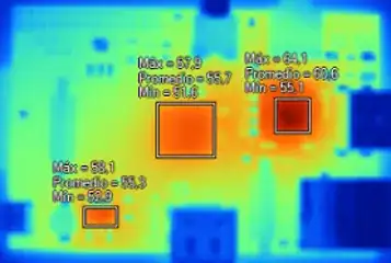

You can put a heatsink on top of the CPU, but as you can see in the picture below, the CPU isn't the hottest part of the board.
Thermal Image of the RPi
The network chip is the hottest part of the RPi. The site where I borrowed this image sells casings that include a heat sink. If you want to use separate heat sinks, you only need a good way to fix them properly on top of the chips (at least for the time is takes adhesive thermal paste to dry).
I guess the 'sandwich' method the referenced website uses for the casing is a very good option, you got your heatsink and a casing in one.

  • didnt know that it was the network chip... thanks for the answer – psyko666 Jan 06 '13 at 11:12
