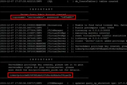

Beside QEMU, you can use ExaGear Desktop for emulation x86 on Raspberry Pi and running Teamspeak 3 Server on RPi. ExaGear Desktop is much more faster than QEMU and allow ts3 server to manage around 50-100 clients on RPi3. Also installation is simpler.
  1. Install ExaGear Desktop, which allow to run x86 software on Raspberry (note that ExaGear isn't free and you have to obtain the license)
    tar -xvzpf exagear-desktop-rpi2.tar.gz
    sudo ./install-exagear.sh
  2. Run ExaGear
    exagear
    Now you entered in x86 world.
  3. I recommend don't run Teamspeak 3 Server under root. So create special user
    sudo adduser teamspeak
    sudo passwd teamspeak
  4. Create installation directory and make teamspeak user the owner of this directory:
    sudo mkdir /usr/local/teamspeak
    sudo chown teamspeak /usr/local/teamspeak
  5. Login as teamspeak user, download ts3 server and unpack archive:
    su teamspeak
    cd /usr/local/teamspeak
    wget http://dl.4players.de/ts/releases/3.0.11.4/teamspeak3-server_linux-x86-3.0.11.4.tar.gz
    tar -xzvf teamspeak3-server_linux-x86-3.0.11.4.tar.gz
    rm teamspeak3-server_linux-x86-3.0.11.4.tar.gz
  6. Start ts3 server
     /usr/local/teamspeak/teamspeak3-server_linux-x86/ts3server_minimal_runscript.sh
    enter image description here Your ts3 server is running. You should copy credentials which will be required for connecting with teamspeak 3 client.
  7. Press CTRL+C and then start the Server in the background
    /usr/local/teamspeak/teamspeak3-server_linux-x86/ts3server_startscript.sh start
Instruction is based on this post
