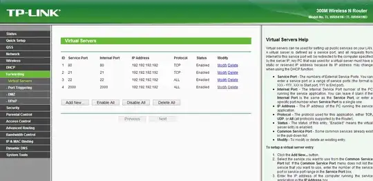

I have an Apache server running on my Raspberry Pi. The Pi is behind a router, having local IP address 192.192.192.192. I use the Virtual Server feature of the router to allow traffic through ports 80, 21, 22 and 2000. My website connects to the Apache server through port 80. I use afraid.org for Dynamic DNS.

- My router is blocking the incoming ports. I don't actually know how to configure the virtual server to redirect incoming mail to port 2000 rather than port 80.

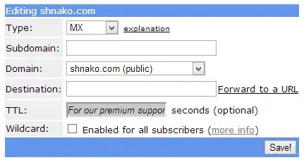

- My MX settings are not good. I'm pretty sure about this, but again, I have no idea what I should set the fields to.
