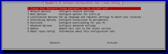

If you enter sudo raspi-config there will be an option to boot directly into the gui at boot time, enable it, reboot and you'll probably be fine.
In this picture the third option will fix your issue. Raspi-config

  • thanks so very much. mine was messed after uninstalling retropie, and using the retropie script to replace the desktop – austin Nov 07 '18 at 01:51
