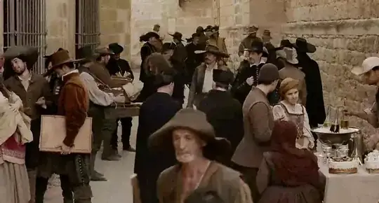

On (1), using Handbrake (x264 codec) I transcoded with x264-settings veryslow and average bitrate 1145kbps (1-pass) which resulted in a 7.7MB file. Profile High, level 4.0. The encoding took 3min 36s using 4 threads. Total cumulated CPU charge of handbrake ~ 380%. Video quality was very good. Little artifacts could be observed and loss of detail not easily observable. See still below.

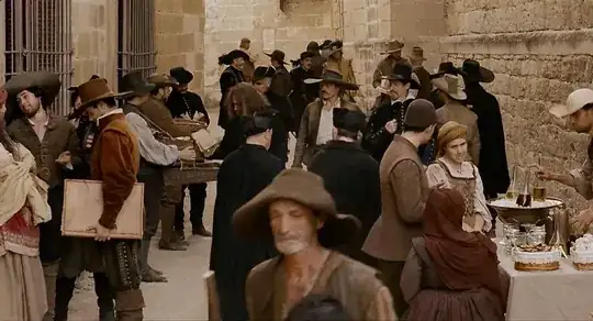

On (2), using GStreamer and omxh264enc (hardware accelerated) I transcoded with target-bitrate=1145000 (1145kbps), control-rate=1 (variable bitrate control method) which resulted in a 6.9MB file. The encoding took 7min 4s using 1 thread. Total cumulated CPU charge of gst-launch-1.0 ~ 100%. Video quality was noticeably degraded with artifacts clearly visible and easily observable loss of detail. See still below.

For a fairly similar file size, the time spent by the hardware-accelerated RaspBerry Pi 2 GPU encoder was almost twice as that of the software x264 encoder on a dual core i7-2620M. Adding up audio transcoding and multiplexing could close a bit this gap due to the largely unused CPU on the RaspBerry Pi during this test. Video quality was clearly superior on the software-encoded file. See stills below.

QuickTime X still of 720p video transcoded using HandBrake (x264) on a MacBook Pro (open or download image for the full detail):
QuickTime X still of 720p video transcoded using GStreamer (hardware encoding through OpenMAX) on a Raspberry Pi 2 (open or download image for the full detail):

Following ecc29's suggestion of using lanczos scaling method I performed a test adding method=lanczos to videoscale. The encoding process doubled in time, jumping from about 7min to 14min 37s. The result is almost equal in quality to that without method (default bilinear). Indeed, the defects mainly come from the encoding process in hardware. They are clearly compression artifacts.
