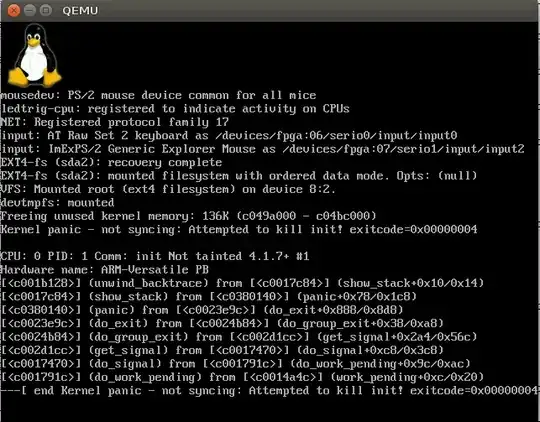

But I always end up with a kernel panic right after booting:
After searching the web, I suppose the error is maybe because kernel and img do not fit each other. If so, where get the right kernel from?

  • Your commandline explicitly emulates an older CPU than Kano supports . Try settting the CPU to cortex-a9 . – flakeshake Dec 04 '15 at 08:38
  • @flakeshake With -cpu cortex-a9 I get:
    `Uncompressing Linux... done, booting the kernel.
    Error: unrecognized/unsupported processor variant (0x410fc090).`
    – nachtigall Dec 04 '15 at 18:55

Yes and no. It is not possible to run the official kano IMG in Qemu but you can run Raspbian and add the kano repositories to the sources.list file.
Install Raspbian Jessie on Qemu (This is for windows, just remove the .exe and stuff): Do this
Add this to /etc/apt/sources.list.d/kano.list:
deb http://repo.kano.me/archive-jessie/ release main
deb http://repo.kano.me/archive-jessie/ release-urgent main
Run this to get the gpg:
wget -qO - http://repo.kano.me/archive-jessie/repo.gpg.key | sudo apt-key add -
Then run:
sudo apt update
sudo apt install kano-os #Which will install everything preinstalled on kano
You won't get the 'white rabbit' setup or anything, but on the next reboot, you will very likely get a kano desktop!
