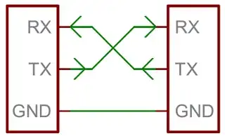

  • Serial - there are two serial Pins on each Pi's GPIO, you should be able to connect them to get a basic serial connection:
    enter image description here Source
    You could then emulate a network connection over that.
