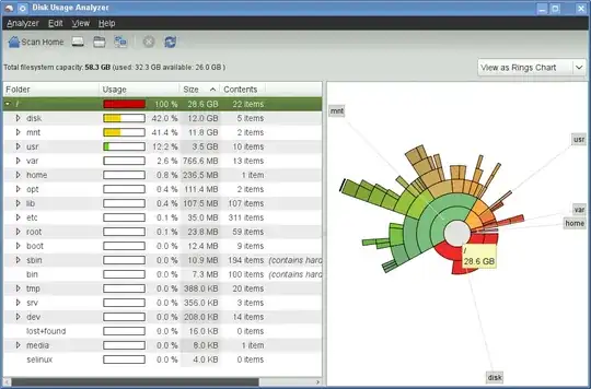

I needed to do the same thing a few month ago, so in addition to all the great answers, here are some of the guides I used tips from.
I've used Disk Usage Analyzer first, removed some of the files but then followed these guide for more specific files I was unsure about removing(without messing the OS up too much)
Disk Usage Analyzer
