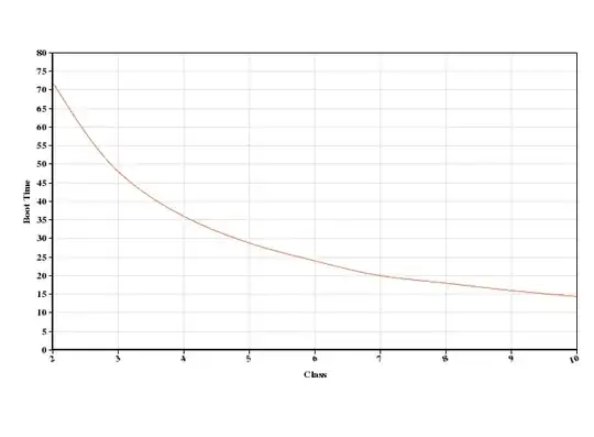

This is completely dependant on the Class of SD card you are using.
A Class 4 card, which is the minimum recommended has an average read/write speed of 4 MB/sec.
If you spend a little extra and buy a Class 10 card, you should find that the boot time is approximately 25% of the Class 4, as it should read at 10MB/sec.
Using finnw's estimate that 24 seconds pass while using a Class 6 we can guess this could be reduced to 14.4 seconds with a Class 10 device.
Classes 2-10 will give you boot times something like this:
