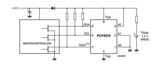

You can use I2C SRAM modules, like the PCF8570P £1.50ish 256x8Bit SRAM. It operates between 2.5V and 6.0V, has a power saving mode that draws as little as 50nA and can be stacked to create more RAM if needed.
Hook it up to I2C directly or to a Master for multiple I2C device. Only uses 2 GPIO, Power and Negative, with the option of MCU power off RAM retention using a small battery.
Alex Chamberlains security concern should be taken seriously if you wanted to protect the Private Key. Possibly thinking about creating some kind of isolation in your code which requires escalation to access to the SRAM.
