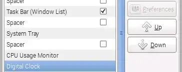

Normally, LXDE provides an option to change the clock format by opening Panel Preferences, selecting "Digital Clock", and clicking Preferences. However, this is disabled:
How do I change the format?

Now for the fix. Open a terminal and run:
leafpad /home/pi/.config/lxpanel/LXDE-pi/panels/panel
(Substitute leafpad with a console editor such as vi or nano if desired.)
Locate the following line:
ClockFmt=%R
...and change it to:
ClockFmt=%r
Save the file and either reboot or restart LXDE.
