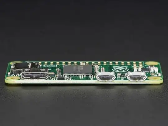

You’d need Raspberry PI Zero for OTG or so called Gadget Mode. Data USB port can be used for OTG and “power”. As of time of this writing Serial and Ethernet were tested, but others should work with proper amount of efforts (keyboard, disk, camera, etc.) Composite devices should work as well. See more info at
The work is expected to be merged into rpy-4.4 version of kernel for OTG functionality to be available OOTB for simpler hacking.

Time to provide an updated answer.
On the B, B+, 2B, 3B and 3B+ USB device mode is not possible because the USB controller on the SoC is connected to a USB Hub with Ethernet chip, not directly to a port.
On the A, A+ and 3A+ device mode is possible but the port must be forced into device mode (IIRC this is done through a device tree overlay), since there is no OTG ID pin. You will also need a USB A to A cable to make the connection.
On the zero, zero W and the 4B device mode is possible out of the box.

Can the Pi Emulate an HID device with via USB?
This can be done with ANY kind of Pi
The least-expensive solution is to use the Pi Zero.
The text of this link is way too long to post here, but the Zero can be any kind of HID. Keyboard, mouse, flash drive, camera, whatever you can think of.
Turning your Raspberry PI Zero into a USB Gadget
Making it a keyboard or mouse is easy.
