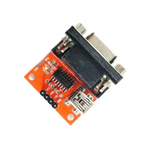

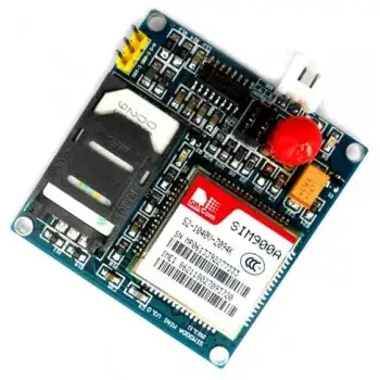

I have connected Raspberry Pi to GSM sim900a mini with the following details:
  • convertor max3232 used
  • DB9-2 sim900a connected to DB9-3 max3232
  • DB9-3 sim900a connected to DB9-2 max3232
  • tx (raspberry) connected to tx (max3232)
  • rx (raspberry) connected to rx (max3232)
But there's no respond through miniterm.py as I run the command below:
sudo miniterm.py /dev/ttyAMA0
I don't Know why the transfer (send/transfer) is not working.
Sim900A MAX3232
Maria
I have figured out that I can connect to the Raspberry using the UART interface directly. I was using the rs232.The problem is solved then.
